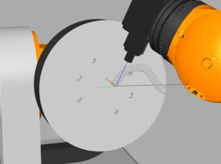

I'm using the G-code importer to import 3D slicing data frum Prus Slicer and I'm running into a problem with the extrusion values. For some reason the last E1 value from a print move is repeated for travelmoves.
I've tested some things, like using a GO code instead of a G1 code for travel moves, but same result.
Anyone facing the same issue?
I've attached textfragments of the same part in both G-code input as well as the KRL output.
