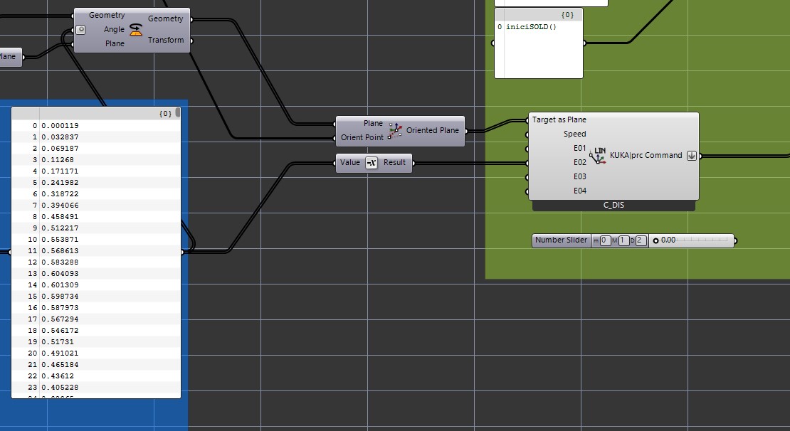

Hello, we have been using this script to turn the tool on and off during fabrication.
But we are unable to do this with a new tool. It needs these text commands to switch on and off.
fiSOLD() = OFF
WAIT SEC 2
iniciSOLD() = ON
I am Unable to add these text commands to the PRC command script. Do you know how we can do this?
Regards,
Ojas Mahajan.
Johannes @ Robots in Architecture
Hello,
The Custom KRL component allows you to add any commands to the output KRL file. Just note that those commands won't be simulated.
Best,
Johannes
