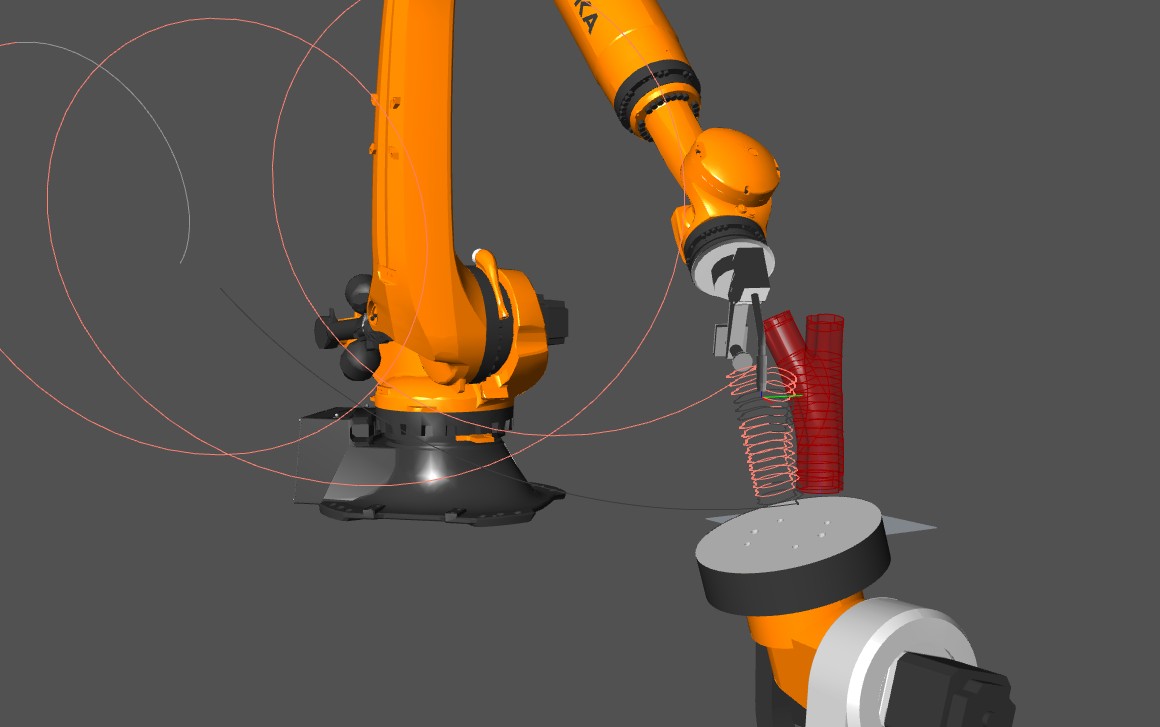

Hello,
Can someone help me get the proper method to reorient the planes so that the robot has the minimum movement and the turn table makes sure the tool is perpendicular to the floor? I have been trying to do this with all the old data on the forum, but I have been unable to get it right.
Thanks,
Ojas

OXIDO
#2
I have already tried this. If you look at my cluster, you will find this definition inside... Also, the planes need to be perpendicular to the floor....

OXIDO
Hello Johannes,
We tested your program, it works well, but not for our user case. I have used your code to get the e1 and e2 in a position where they are correct, but I need help reorienting the plans to compensate for the movements of e1 and e2. You can find the problem in the Gh file attached. The E1 and E2 are correct..
Hope you can help...
Ojas

OXIDO
Hello Johannes,
I understand this, but the rotation changes the X and Y axes, and the robot moves with the table. I need the tool to be in one place... I hope the video can explain the problem better
OXIDO
Hello Johannas,
This version of the program is close to what I need. Can you check the GH file and see if you can improve it?
Regards,
Ojas
